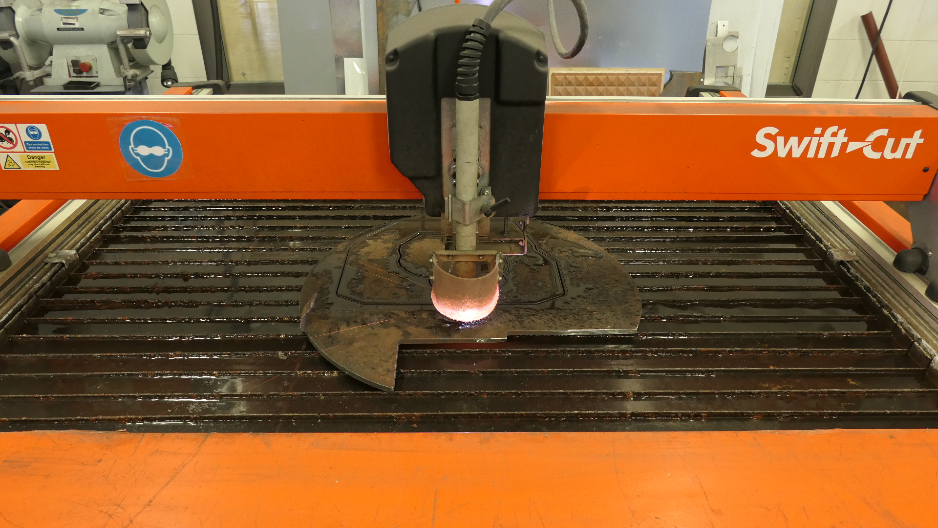

at the moment I am testfitting the motor these thin plates are only for testing that I cut with CNC plasmacutter. CAD drawings were made with my students with whose help we prepared the g-code files for plasmacutting with Swift Cut plasmatable.

I made a lasercut cardboard template to see if measurements are ok.
plasmacut the spacer out of 10mm steel
and that's how it looks
