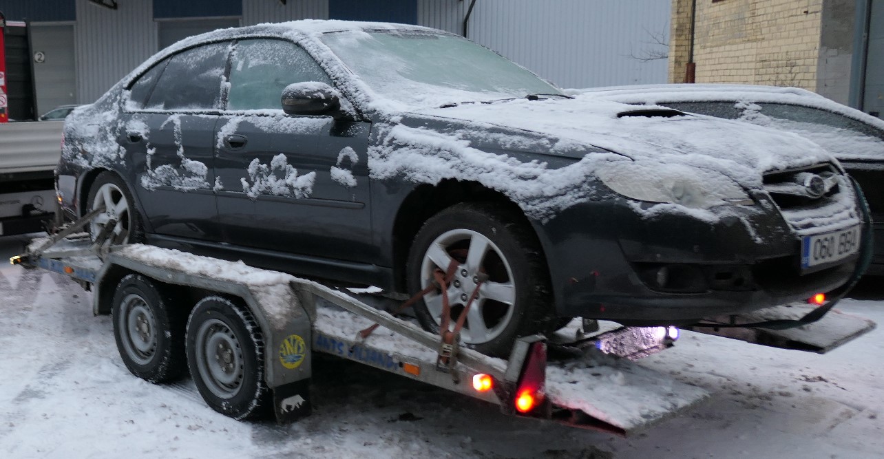

This is my first all wheel drive car. Bought it because we have winters with snow and ice here. I am driving daily i-MiEV (RWD) or Leaf (FWD) and frequently feel that with one driving axle electric motor potential is not fully used. I have had a chance to try Jaguar i-pace, so I wanted and electric 4WD car for myself too.
The car was already without diesel boxer engine. Seller told me that this car was the first new diesel Subaru sold in Estonia. I want to give this car second life with electric power. Body is not bad, much better then my first car conversion. But I'll lift it up and then we'll see what I got. There are plastic covers on sides and under covers also, these need to be removed to see the real situation.
Buying decision was made when I saw here in openinverter forum two Legacy models that's conversion has been started. And I saw that these cars have electric power steering! This is very important since steering system changing is not allowed here. I will keep the original manual transmission to get it running like 4WD car should and attach first gen Leaf motor to it.

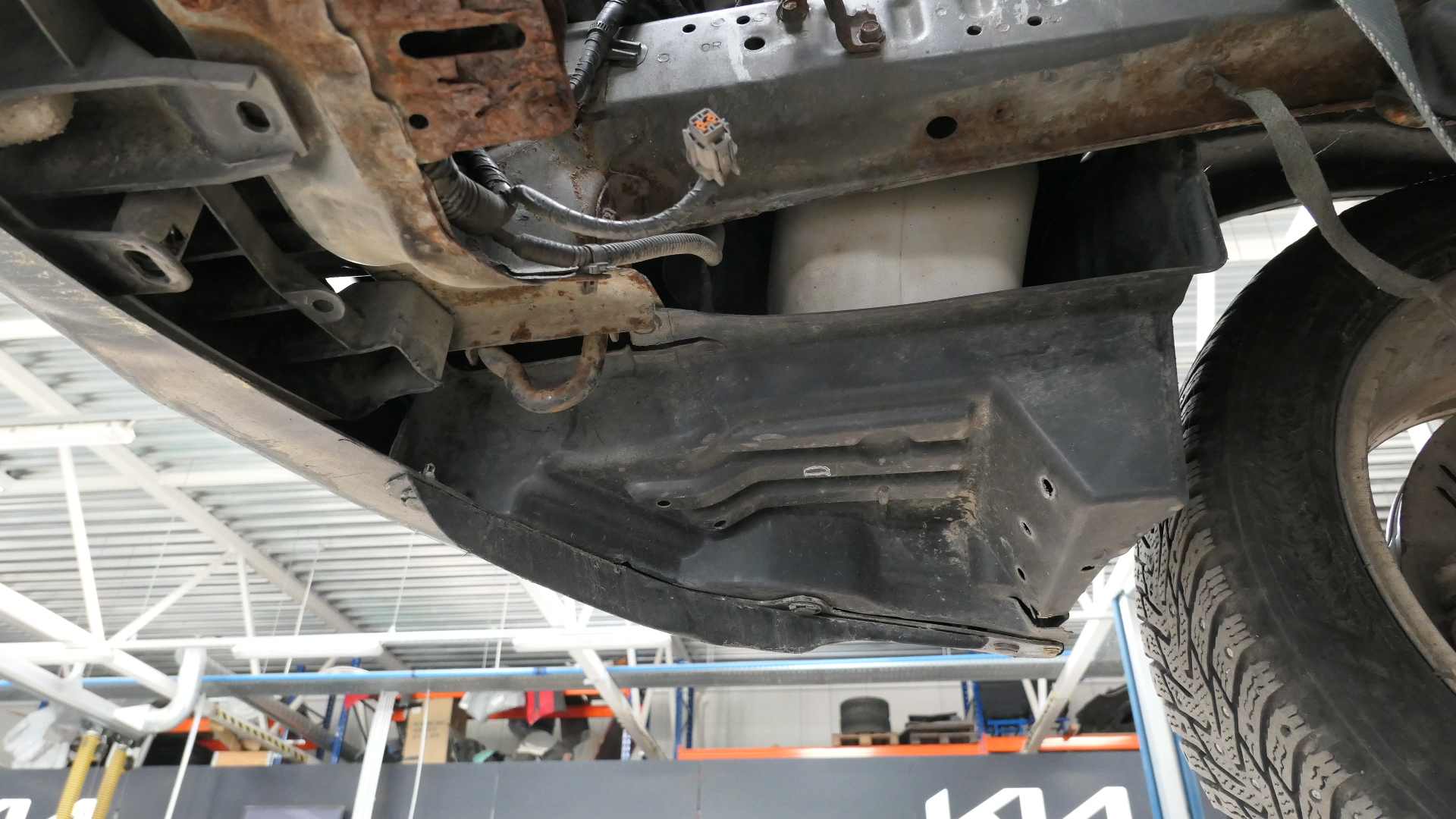

Today washed the car and lifted up for the first time. Under body plastic covers were broken and they carried a lot of sand. Some bolts didn't come loose and snapped. Removed the exhaust pipe I'll try to sell it, seems like its stainless steel so I don't know if anybody needs it.
In the summer I should sandblast the underfloor and stop the rust.
I'll find new used plastic covers.

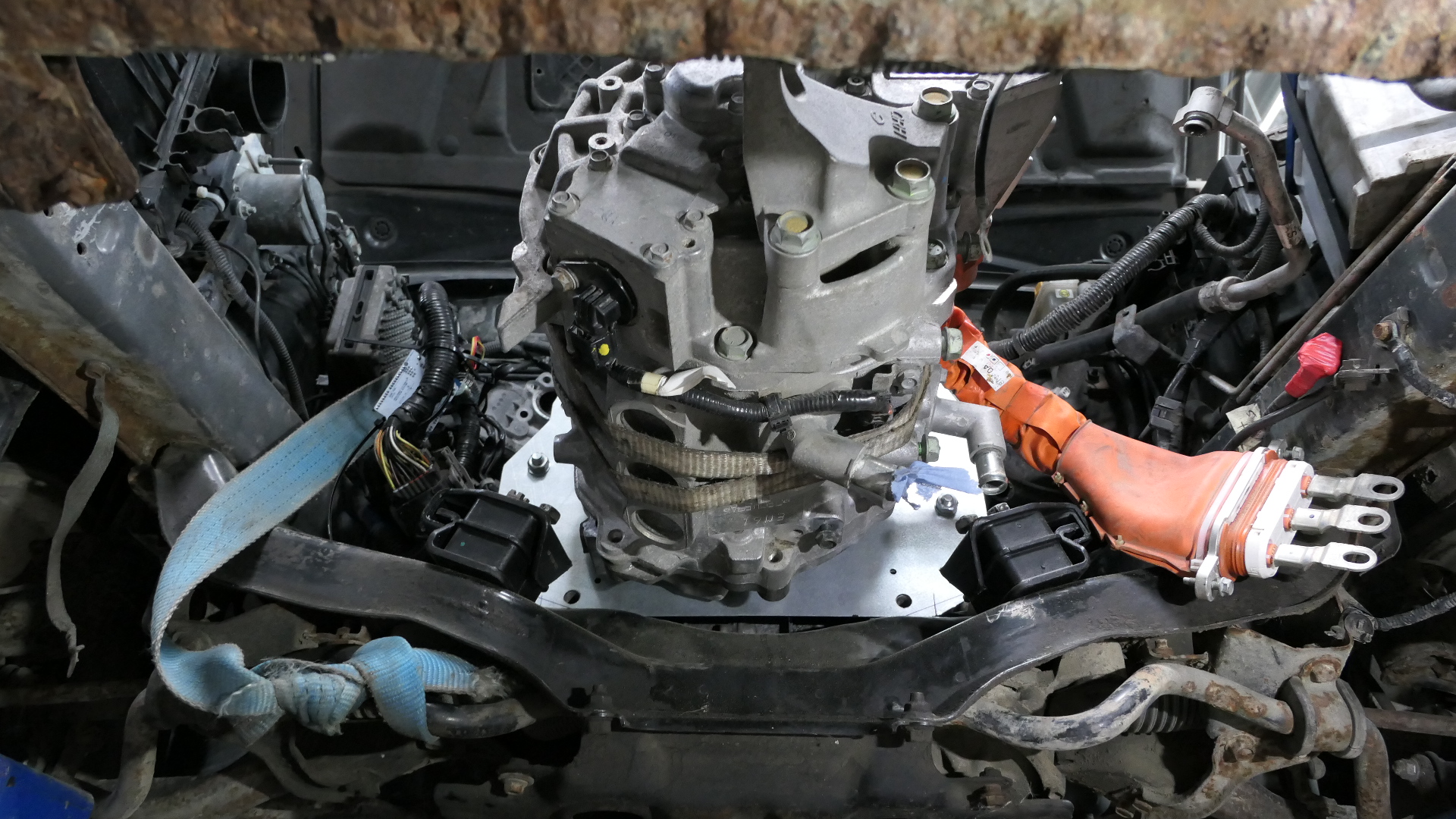

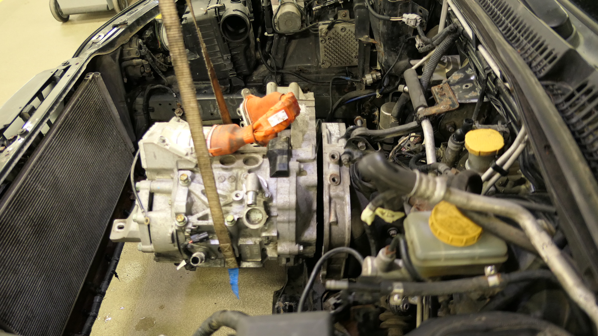

Trying for the first time how the Leaf motor fits
Motor and gearbox shafts are touching but there's still a gap. I'll make a adapter plate from steel about 14mm thickness. Motor position in this car is strange it's not horisontal and a lot of room is wasted under the motor but what to do, under there is very bad place for anything. Our roads in winter time are salty muddy and sandy. I'm thinking maybe adding somekind of frame and adding a few Leaf original motor mounts in addition to subaru original mounts. Then it would be easier to attach all the other parts like AC compressor, Leaf HV junction block, inverter, on board charger and so on.

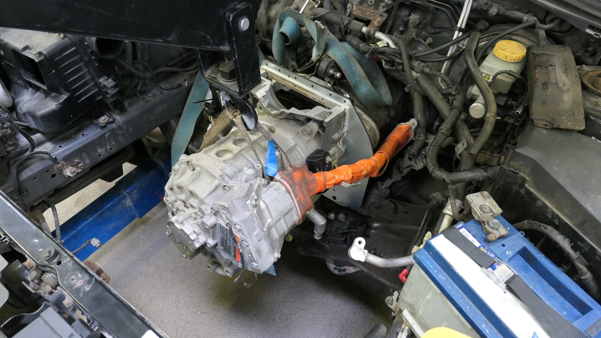

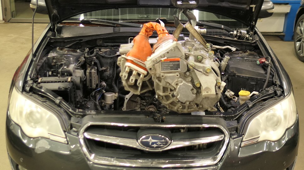

Now that the schoolyear is ending I have done a few things on my Subaru.
My colleague changed rear boot lid, with students, old one was veru rusty, fortunately I got other one just the same color and rust free!

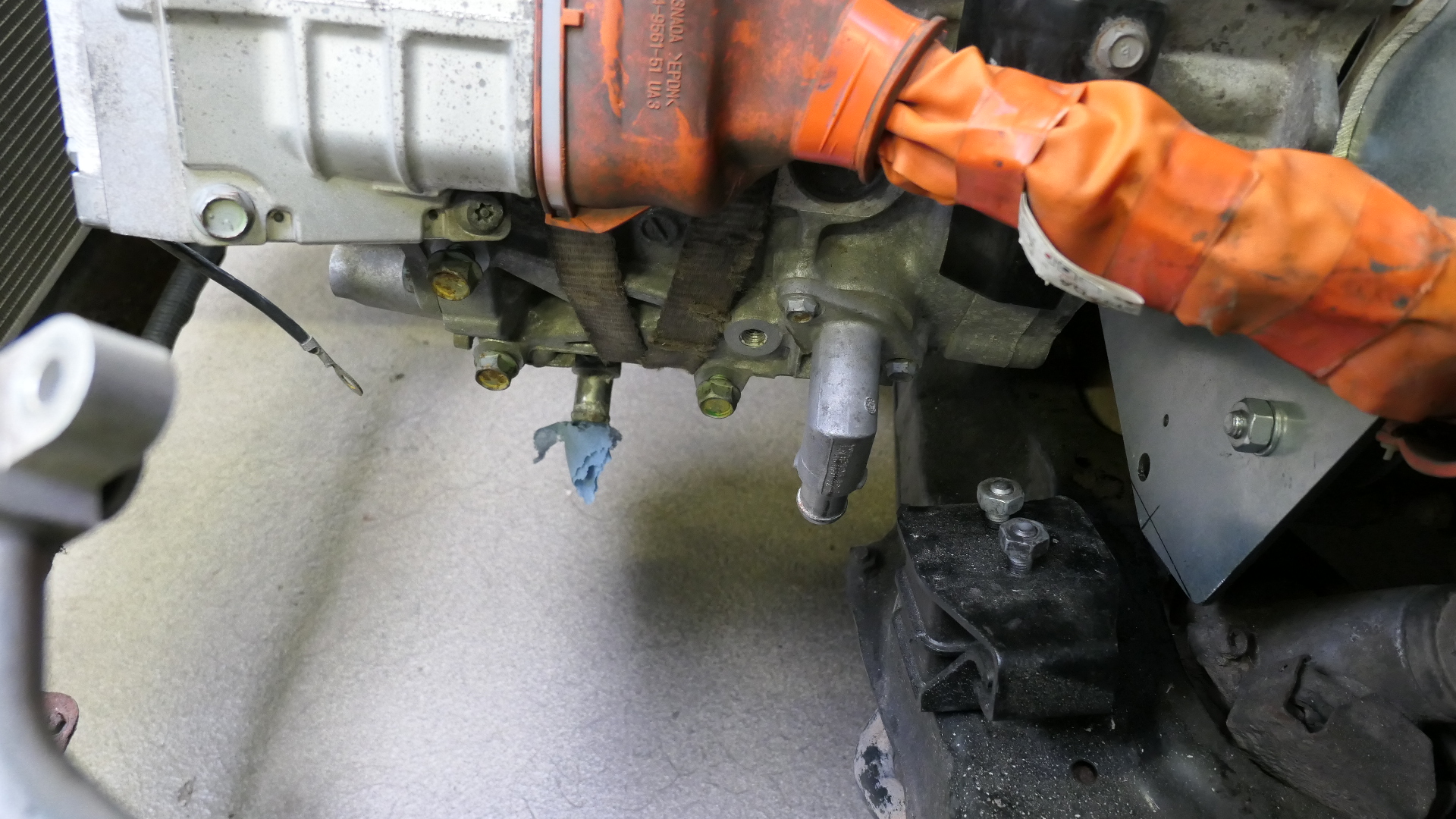

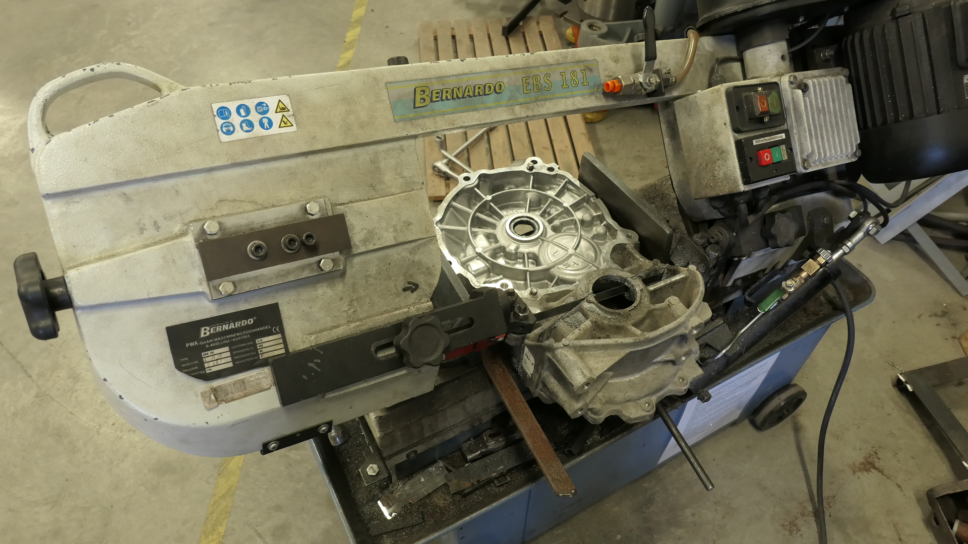

Cut off the differential part from the leaf reducer case half.
When testfitting it I found out that I have to rotate the motor 90 degrees.
Seems to be fine, cooling pipes seems to be ok and even the AC compressor should go onto the original mounts on the motor.
at the moment I am testfitting the motor these thin plates are only for testing that I cut with CNC plasmacutter. CAD drawings were made with my students with whose help we prepared the g-code files for plasmacutting with Swift Cut plasmatable.
view from bottom
I think I need to make rear support also for the motor but there's not a strong place to attach it.

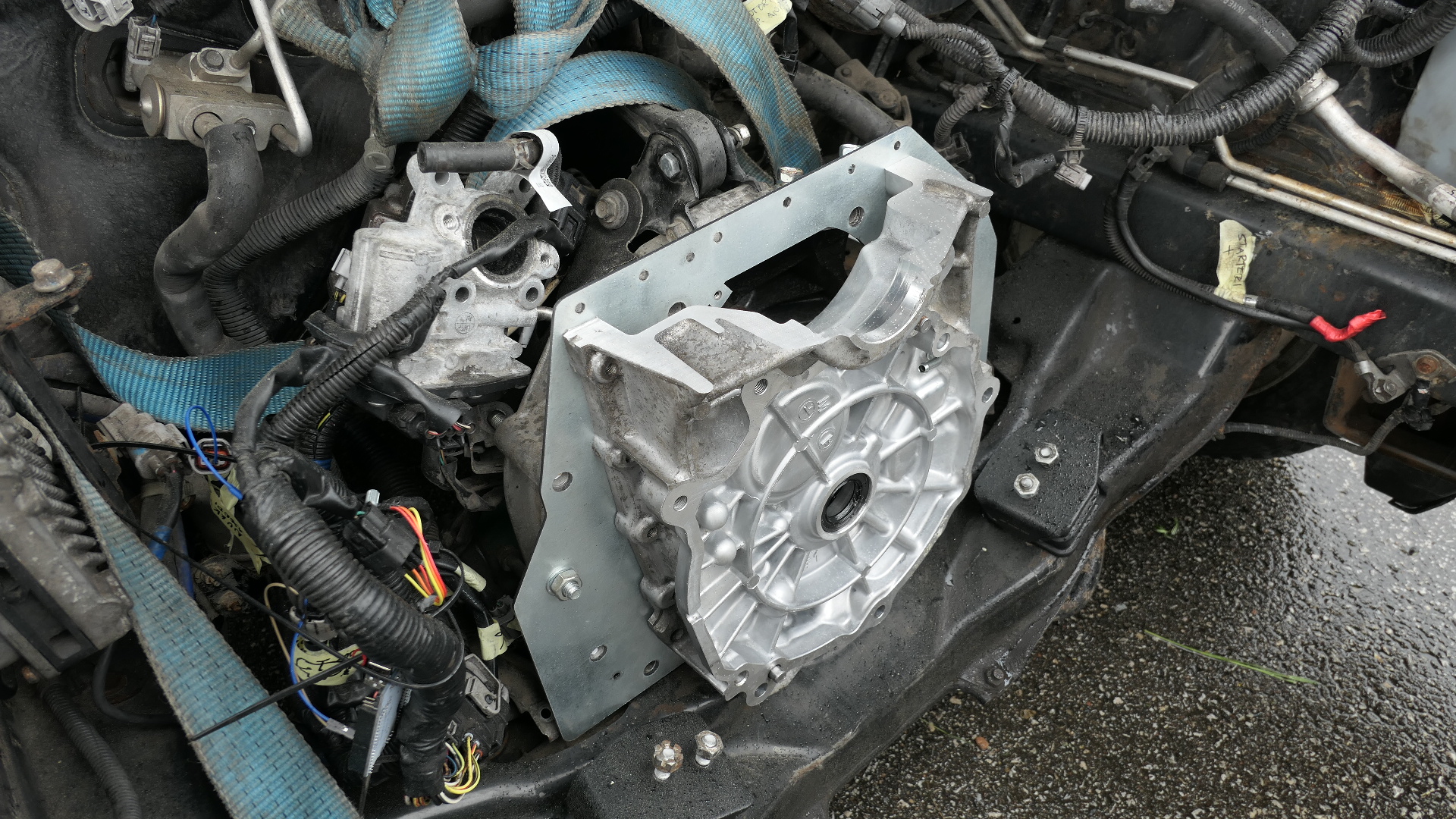

I made the coupler from Leaf reducer part where I had to cut input shaft shorter and turn a space for subaru clutch disk center piece
welded them together
thats how it looks on the subaru gearbox

I made a lasercut cardboard template to see if measurements are ok.
plasmacut the spacer out of 10mm steel
and that's how it looks
Ruudi S
- Posts: 105
- Joined: Sun Apr 12, 2020 2:02 pm
- Location: EU Estonia
- Has thanked: 67 times
- Been thanked: 32 times
Re: Subaru Legacy AWD 2008, Leaf motor
Adapter plate and coupler done!
gearbox side
electric motor side
adatpter board attached to gearbox and onto the motor mounts
motor attached
gearbox side
electric motor side
motor attached

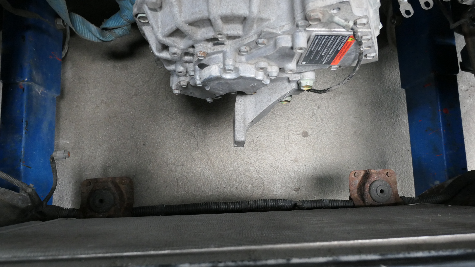

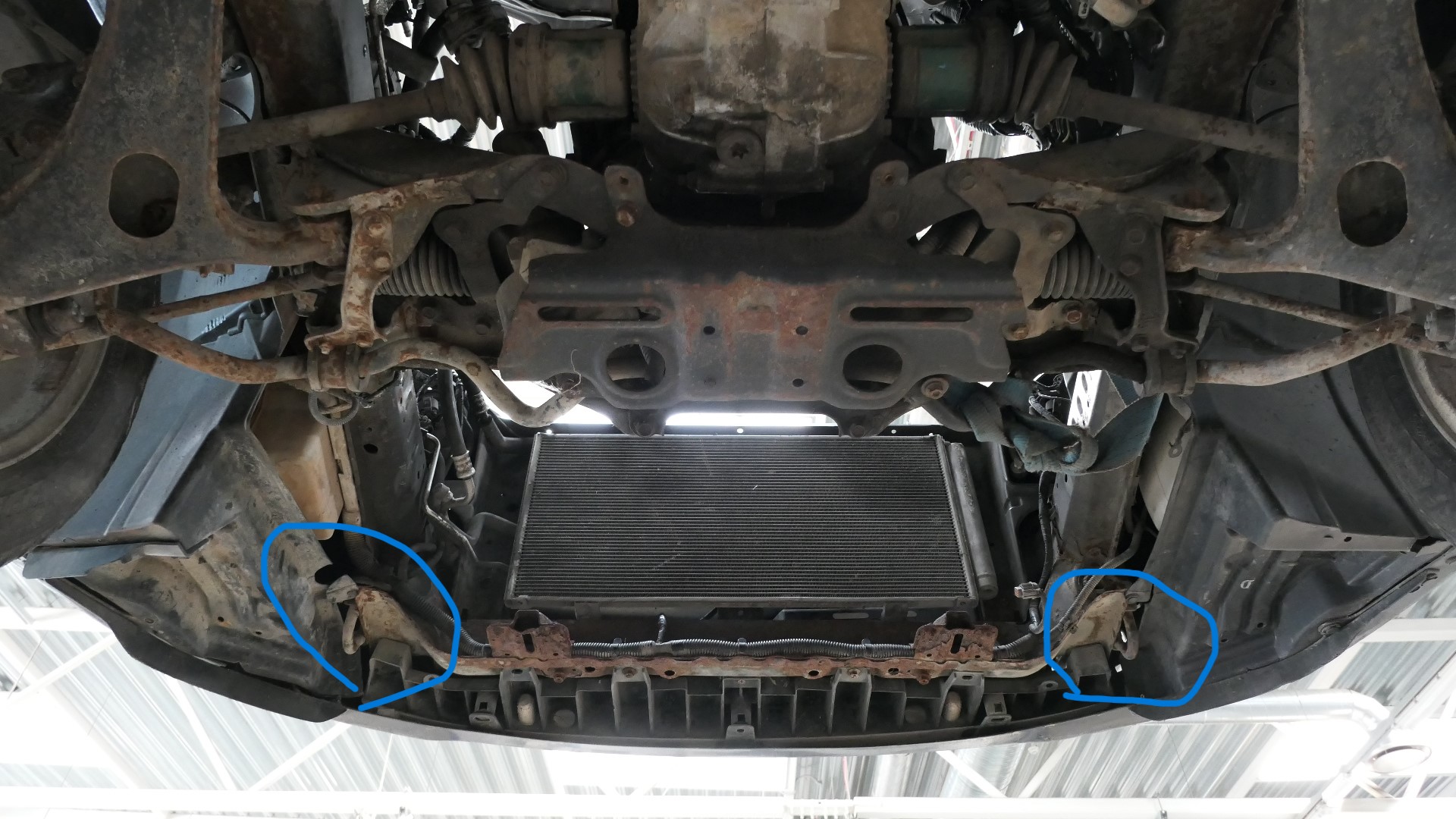

When the car was on the car lift I found two strange hooks under the front longitudinal beams I'll construct somekind of frame under the motor to attach PDU module and coolant pumps and other parts that I cannot think of right now.
At the moment I am not worried about this motor attachment because the original diesel boxer was also attached the same way. And I have been busy with exploring and wondering Zombieverter VCU and how it works. Also tried to get working this VW PHEV battery pack contactor box or ebox thing with very little success.
tow hook?
- Posts: 3796
- Has thanked: 166 times
- Been thanked: 413 times
I think those hooks are towing arrangement because your car has alu suspension and if towing truck would hook subaru by the suspension arms it could damage them. So the hooks... if you would cut or change them you need to leave at least one of them usable or weld/bolt another towing arrangement to the front beams... some day you might neet it.

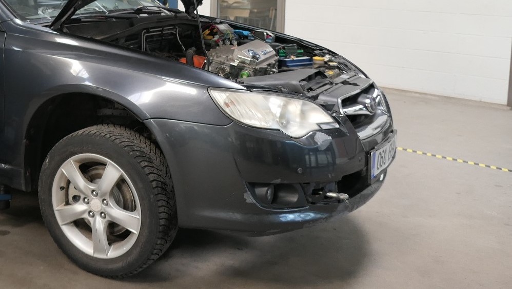

Hooks that I am talking about, are so high, when someone would use them he's gonna brake front bumper lower part for sure.arber333 wrote: ↑Sat Aug 23, 2025 8:45 pm I think those hooks are towing arrangement because your car has alu suspension and if towing truck would hook subaru by the suspension arms it could damage them. So the hooks... if you would cut or change them you need to leave at least one of them usable or weld/bolt another towing arrangement to the front beams... some day you might neet it.
I haven't seen any alu suspension parts under this car, it's just another cheap japanese car except its all wheel drive.
It has, screw on, towing hook in the bumper.
blue markings show the hooks I am talking about
bumper tow hook attached

those are for sure towing hooks. But i am really at a loss why so high... maybe your bumper has provision for that?
I have the same set on Mazda, its just they are lower down at the wheel well.
If i used them i would also brake my bumper i think though...
jrbe
- Posts: 766
- Has thanked: 363 times
- Been thanked: 249 times
The hooks are for tie downs to a flatbed or a trailer. Tow truck drivers usually use things like control arms or stick T hooks into frame holes which distorts the frame and adds a spot for rust to start. Sometimes they use halfshafts, swaybars, etc. Its nice that the engineers thought about adding a convenient and strong spot to tie down the vehicle.
Tow hooks are usually in the bumper cover but if you watch a tow truck driver load up a car with them, it becomes very clear that they are not the best solution when they keep going with the winch to pull down on the car.
The tie down hooks can also be a less than ideal spot to attach to for pulling up the flatbed if its high, kind of rips up on the bumper cover.
You very likely wont find a tow truck / flatbed driver that takes the time to not damage your car. Its about minimizing the damage and making sure it stays put.

Myself when bringing cars with trailer I use that kind of straps that are meant to attach the wheel to trailer. And some of our tow truck drivers also use these.jrbe wrote: ↑Sun Aug 24, 2025 1:07 pm The hooks are for tie downs to a flatbed or a trailer. Tow truck drivers usually use things like control arms or stick T hooks into frame holes which distorts the frame and adds a spot for rust to start. Sometimes they use halfshafts, swaybars, etc. Its nice that the engineers thought about adding a convenient and strong spot to tie down the vehicle.

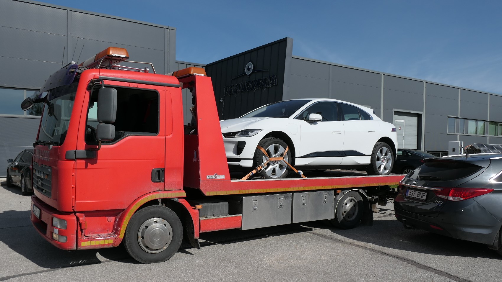

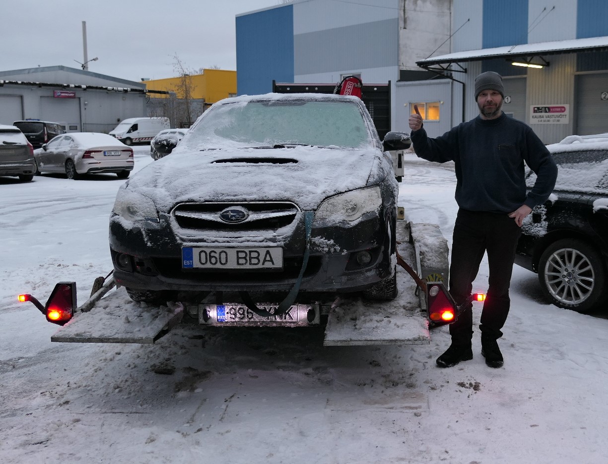

Bringing Legacy home, it didn't have motor and it barely moved.
One tow company took a Jaguar to dealer for motor setup after I changed the front drive unit.
