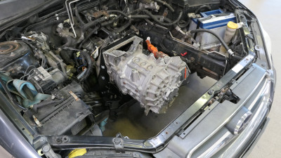

Now that the schoolyear is ending I have done a few things on my Subaru.
My colleague changed rear boot lid, with students, old one was veru rusty, fortunately I got other one just the same color and rust free!
Cut off the differential part from the leaf reducer case half.
When testfitting it I found out that I have to rotate the motor 90 degrees.
Seems to be fine, cooling pipes seems to be ok and even the AC compressor should go onto the original mounts on the motor.
at the moment I am testfitting the motor these thin plates are only for testing that I cut with CNC plasmacutter. CAD drawings were made with my students with whose help we prepared the g-code files for plasmacutting with Swift Cut plasmatable.
view from bottom
I think I need to make rear support also for the motor but there's not a strong place to attach it.

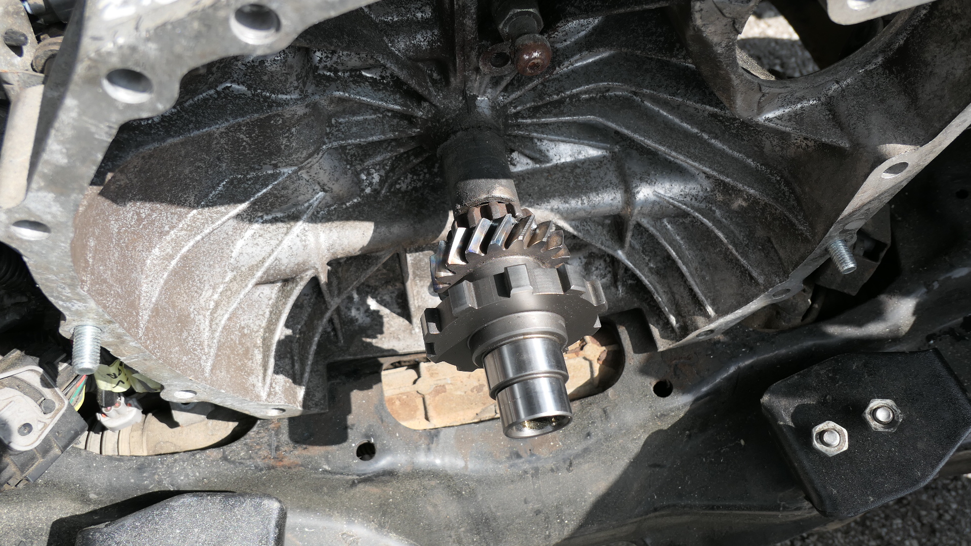

Now need to work on the spline shaft coupler things
Ruudi S
Posts: 105
Joined: Sun Apr 12, 2020 2:02 pm
Location: EU Estonia
Has thanked: 67 times
Been thanked: 32 times
Re: Subaru Legacy AWD 2008, Leaf motor
Post by Ruudi S »
I made the coupler from Leaf reducer part where I had to cut input shaft shorter and turn a space for subaru clutch disk center piece
welded them together
thats how it looks on the subaru gearbox

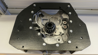

I made a lasercut cardboard template to see if measurements are ok.
plasmacut the spacer out of 10mm steel
and that's how it looks
Ruudi S
Posts: 105
Post by Ruudi S »

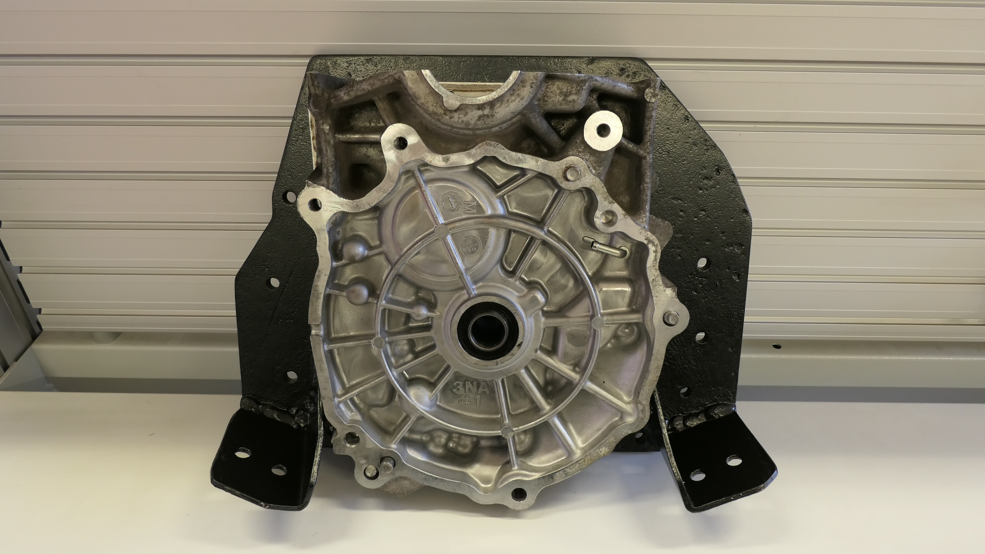

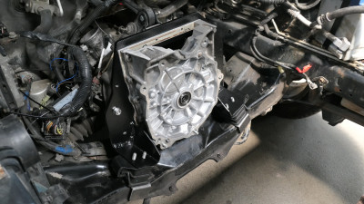

Adapter plate and coupler done!
gearbox side
electric motor side
adatpter board attached to gearbox and onto the motor mounts
motor attached
