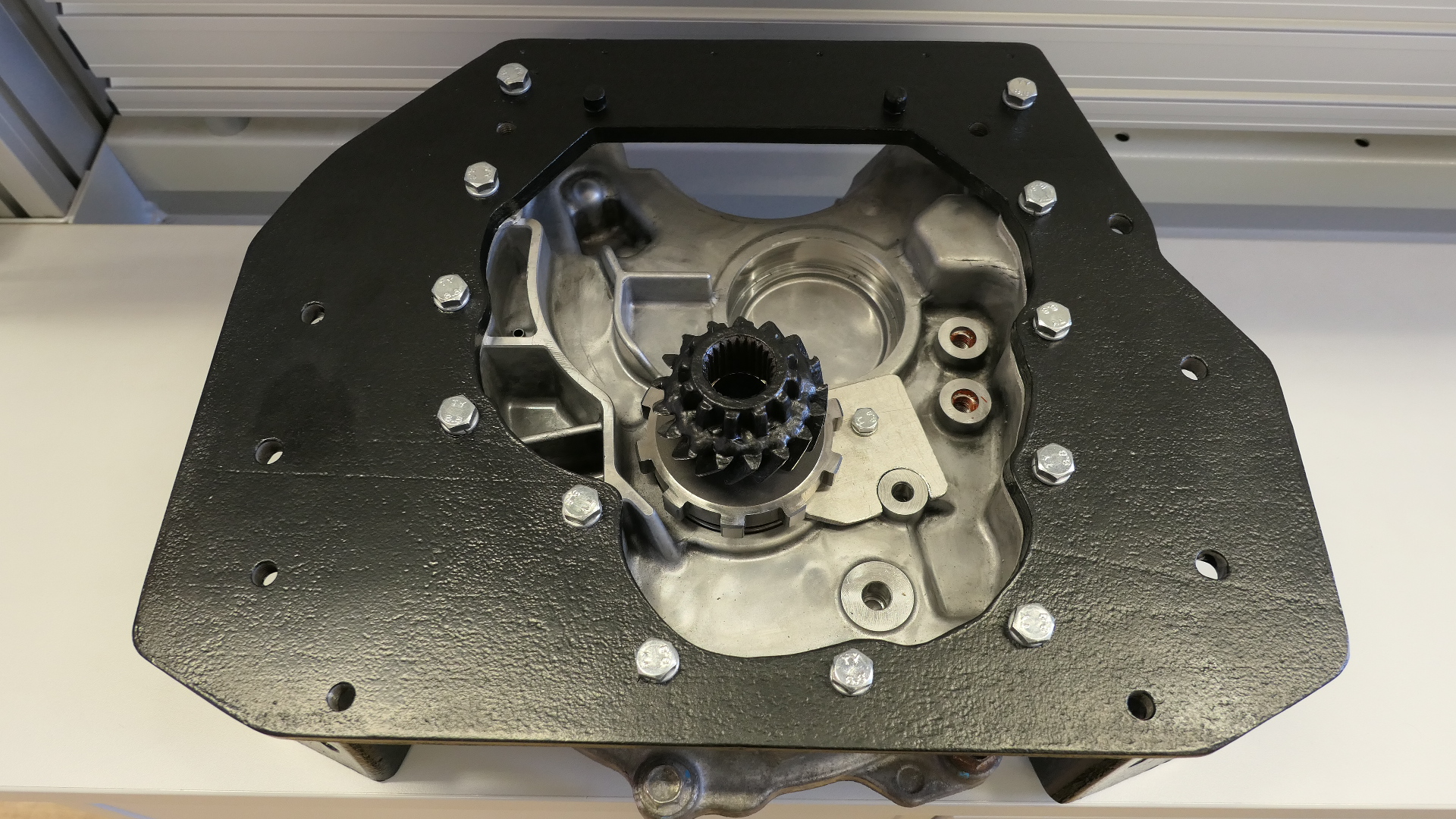

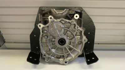

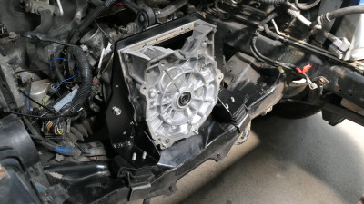

Re: Subaru Legacy AWD 2008, Leaf motor
Adapter plate and coupler done!
gearbox side
electric motor side
adatpter board attached to gearbox and onto the motor mounts
motor attached
